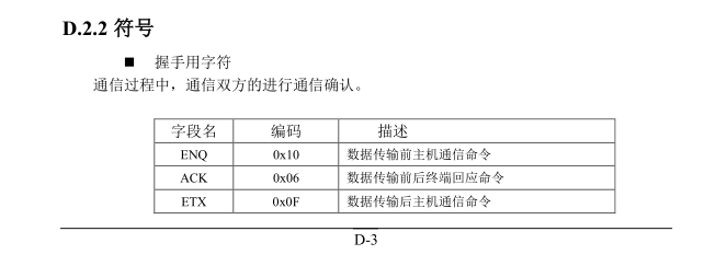

不知道应该怎么写接收指定字符并自动回复指定字符的代码?
求一段代码。。。多谢了!

select case e.port.portname
     case "com3"
        dim v as byte = ports("com3").readbyte
        if v = 16 then
             dim val() as byte = new byte() {6}
             ports("com3").write(val,0,val.length)
        end if
end select
提示写入超时????

在串口调试助手里得到的数据如下:
CTRSampleInfo SampleID1Mode0TestTime2017-05-08 08:50:34NameGender0Group0AgeVal0AgeType0DeptChartNoBedNoSenderTesterCheckerWBC Val9.6Low4.0High10.0Unit10^9/LLymph# Val2.2Low0.8High4.0Unit10^9/LMid# Val0.7Low0.1High1.5Unit10^9/LG72 61 06 n# Val6.7Low2.0High7.0Unit10^9/LLymph% Val23.4Low20.0High40.0Unit%Mid% Val7.7Low3.0High15.0Unit%Gran% Val68.9Low50.0High70.0Unit%HGB Val133Low110High160Unitg/LRBC Val4.00Low3.50High5.50Unit10^12/LHCT Val38.7Low37.0High54.0Unit%MCV Val96.9Low80.0High100.0UnitfLMCH Val33.2Low27.0High34.0UnitpgMCHC Val343Low320High360Unitg/LRDW-CV Val13.6Low11.0High16.0Unit%RDW-SD Val50.1Low35.0High56.0UnitfLPLT Val159Low100High300Unit10^9/LMPV Val7.7Low6.5High12.0UnitfLPDW Val16.8Low9.0High17.0Unit PCT Val0.122Low0.108High0.282Unit%P-LCR Val22.1Low11.0High45.0Unit%AlarmFlag Rm0R10R20R31R40Pm0Pl0Ps0SepLine SepWBCLyLeft10SepWBCLyMid56SepWBCGranMid81SepWBCGranRight255SepRBCLeft27SepRBCRight195SepPLTLeft6SepPLTRight118WBCHisto DataLen256MetaDataLen1WHistoData*******,>Tj$3:?DMRTZY^`_]^_`ed\YRSKF:*'%
}|uqlljijigdb^\YXVZWWY\addflu{|~
"*02:869676<:<BEEGNOPUZ]ddddefghhehfiorvw{z}xwztwqrqni``]_[XQMKGB92.1-,+%# xtqmdc][[VTTPLIGB@71-+*$!   RBCHisto DataLen256MetaDataLen1RHistoData****************  '08BLXep
&4DNZenw{~{{sne\RHA5/$
xpfb^ZVRPMIGB@=;:875530.+)'%#"
***********PLTHisto DataLen256MetaDataLen1PHistoData***** /BXp4H\lx~~|wqg[RJD=5-(%! yqib]XQKECDEEDCAA???==<;:977521.,*(&#" !!
*!t***n 4**%5G**8************************************************************
06
现在我卡在回复主机16进制的06这里
