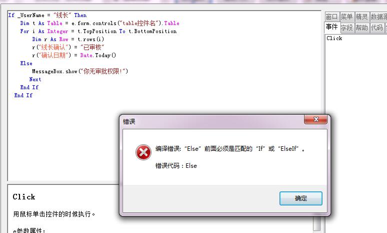

改成
If _UserName = "线长" Then
e.form.controls("Table1").Table.Current("线长确认") = "已审核"
e.form.controls("Table1").Table.Current("确认日期") = Date.Today()
MessageBox.show("你无审批权限!")
e.form.controls("table控件名").Table.Current("线长确认") = "已审核"
e.form.controls("table控件名").Table.Current("确认日期") = Date.Today()

选中多行?
If _UserName = "线长" Then Dim t As Table = e.form.controls("table控件名").Table For i As Integer = t.TopPosition To t.BottomPosition Dim r As Row = t.rows(i) r("线长确认") = "已审核" r("确认日期") = Date.Today() Next Else MessageBox.show("你无审批权限!") End If

-- 发布时间:2018/3/9 10:18:00
