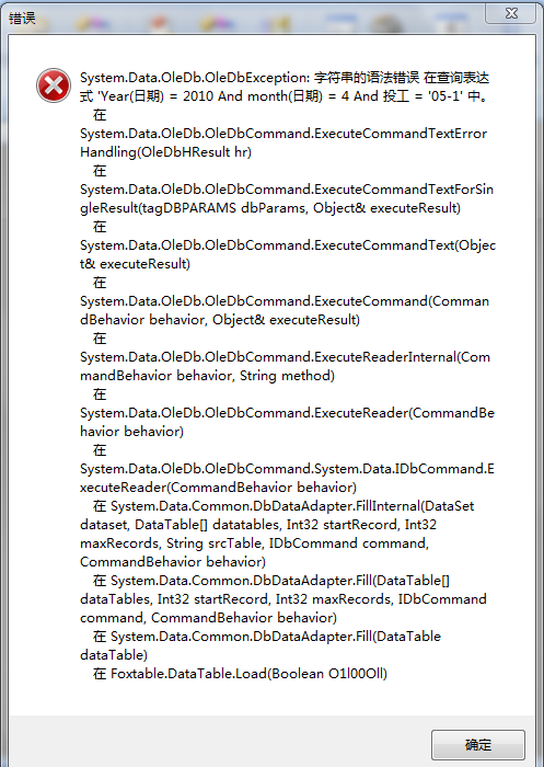

对狐爸老师的代码进行修改后运行出错,请各位老师帮忙看看,错在哪里?

终于找到问题所在,代码中缺少两个分号:
If e.Form.Controls("ComboBox1").Value Is Nothing Then
    MessageBox.Show("请输入报表年月")
    Return
Dim ym As String = e.Form.Controls("ComboBox1").Value
Dim Filter As String = "报表年月 = '" & ym &  "'"
If user.Group = "填报" Then
   filter = filter & " And 单位 = '"  & user.name & "'"
DataTables("日报源表").LoadFilter = filter
问题全部解决,谢谢老师们的热心指教!!
