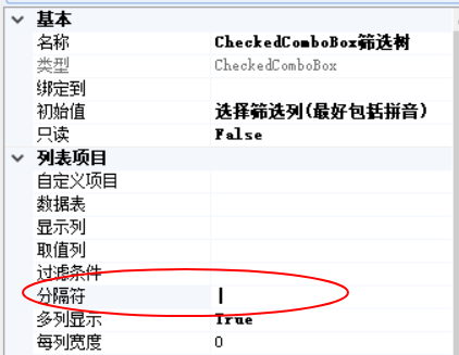

把窗口设计里的sql去掉,然后在组合框textchanged事件
tables("窗口名称_table1").fill("select * from {" & e.sender.text & "}", false)

说明设置里本来就没有值
msgbox(GetConfigValue("目录树表列",""))

因为Enter时间有这么一句代码
e.Sender.ComboList = ""
e.Sender.Text = ""
Dim s As String
For Each dt As DataTable In DataTables
    If dt.Type = 1 OrElse dt.Type = 3 Then
        s + = dt.Name & "|"
