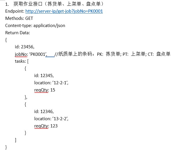

<!--[if !supportLists]-->1.       <!--[endif]-->获取作业接口(拣货单、上架单、盘点单)
Endpoint: http://server-ip/get-job?jobNo=PK0001
Methods: GET
Content-type: application/json
Return Data:
                jobNo: ‘PK0001’,   //纸质单上的条码:PK: 拣货单; PT: 上架单; CT: 盘点单
                tasks: [
                                                location: ’12-2-1’,
                                                reqQty: 15
                                                location: ’13-2-2’,
                                                reqQty: 123

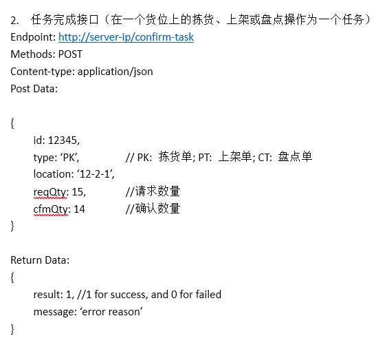

<!--[if !supportLists]-->2.       <!--[endif]-->任务完成接口(在一个货位上的拣货、上架或盘点操作为一个任务)
Endpoint: http://server-ip/confirm-task
Methods: POST
Post Data:
                type: ‘PK’,                             // PK: 拣货单; PT: 上架单; CT: 盘点单
                location: ‘12-2-1’,
                reqQty: 15,                           //请求数量
                cfmQty: 14                           //确认数量
Return Data:
                result: 1, //1 for success, and 0 for failed
                message: ‘error reason’

接口说明如下:
Methods: POST
Post Data:
                location: ‘12-2-1’,
                reqQty: 15,                           //请求数量
                cfmQty: 14                           //确认数量
Return Data:

就是9楼的那个,word和pdf都发不了?
zhutangxin
等级:一尾狐 帖子:480 积分:4121 威望:0 精华:0 注册:2016/10/14 13:40:00
  发帖心情 Post By:2020/6/19 10:03:00 [显示全部帖子]
zhutangxin
  发帖心情 Post By:2020/6/19 10:04:00 [显示全部帖子]
用截图来发吧
