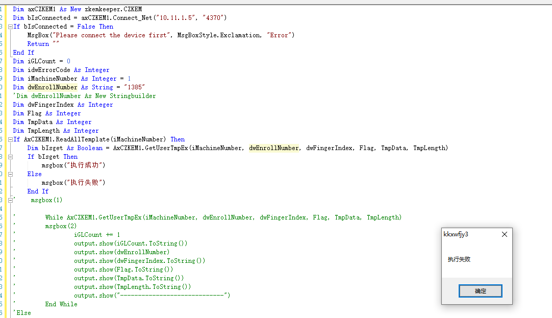

执行函数GetUserTmpEx报错,这里要怎么写
Dim axCZKEM1 As New zkemkeeper.CZKEM
Dim bIsConnected = axCZKEM1.Connect_Net("10.11.1.5", "4370")
If bIsConnected = False Then
    MsgBox("Please connect the device first", MsgBoxStyle.Exclamation, "Error")
    Return ""
Dim iGLCount = 0
Dim idwErrorCode As Integer
Dim iMachineNumber As Integer = 1
Dim dwEnrollNumber As String
Dim dwFingerIndex As Integer
Dim Flag As Integer
Dim TmpData As Integer
Dim TmpLength As Integer
If AxCZKEM1.ReadAllTemplate(iMachineNumber) Then
    Output.Show("OK")
    ''''下载指纹代码有问题
    While AxCZKEM1.GetUserTmpEx(iMachineNumber, dwEnrollNumber, dwFingerIndex, Flag, TmpData, TmpLength)
            iGLCount += 1
            output.show(iGLCount.ToString())
            output.show(dwEnrollNumber)
            output.show(dwFingerIndex.ToString())
            output.show(Flag.ToString())
            output.show(TmpData.ToString())
            output.show(TmpLength.ToString())
            output.show("-----------------------------")
    End While
    AxCZKEM1.GetLastError(idwErrorCode)
    If idwErrorCode <> 0 Then
        MsgBox("Reading data from terminal failed,ErrorCode: " & idwErrorCode, MsgBoxStyle.Exclamation, "Error")
        MsgBox("No data from terminal returns!", MsgBoxStyle.Exclamation, "Error")

msgbox(2)弹不出来

报这个错误

加了初始值之后,就弹出"1",后面不弹出,也没报错

这样不行,报错

输入用户号执行失败
