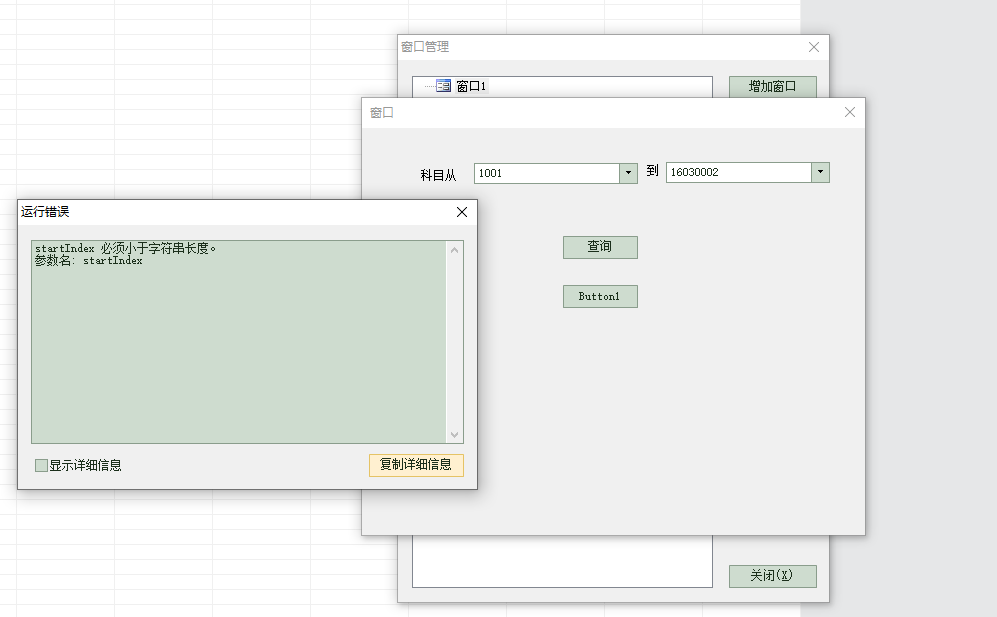

Dim s1 As String = e.Form.Controls("ComboBox1").text
Dim s2 As String = e.Form.Controls("ComboBox2").Text
Dim ss As String = DataTables("表A").SQLGetComboListString("Left(科目,4)", "科目 >'" & s1 & "' and Left(科目," & s1.Length & ") < '" & s2.Substring(0, 4) & "'")
ss = ss & "|" & DataTables("表A").SQLGetComboListString("科目", "科目 >'" & s2.Substring(0, 4) & "' and 科目 <= '" & s2 & "'")
Dim s As String = s2
If ss.Contains(s) = True Then ‘如果不在集合里。(如果在集合里就不需要重复添加了)
ss.Remove(s)
MessageBox.Show(ss)
按此在新窗口浏览图片
zhuxinhui
等级:八尾狐 帖子:2079 积分:7012 威望:0 精华:0 注册:2017/11/8 17:37:00
  发帖心情 Post By:2023/7/14 12:49:00 [显示全部帖子]
移除字符出错了
