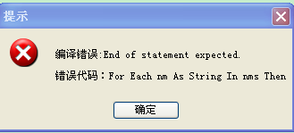

回复:(狐狸爸爸)If Forms("窗口名称").Opened Then...  发帖心情 Post By:2012/5/3 17:28:00 [只看该作者]
狐爸,提示出现问题……
晚上我做个实例发给您,您帮我看看实现下吧~先谢了
  发帖心情 Post By:2012/5/3 17:29:00 [只看该作者]
     Dim nms() AS String = {"Textbox1","Textbox2","Textbox6"}
     For Each nm As string in nms
        Dim v As Double = Forms("窗口名称").Controls(nm).Value
        If v > 0 Then
               Forms("窗口名称").Controls(nm).BackColor = Color.Green
               Forms("窗口名称").Controls(nm).BackColor = Color.Red
        End if
End if
