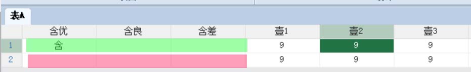

求助 窗口按钮代码,实现
当前表,列名有“含”字的列值=含,列名有“壹”字的列值大于x(窗口文本控件里录入的数值)的行筛选

蓝大师,上楼项目执行没有效果
想实现的效果是 黄色和绿色 2个条件都成立时的行筛选出来
我把上楼代码改成下面还是有问题,多显示了红色的第2行

求助 黄色和绿色 2个条件都成立时的行筛选出来

这个条件不能算都成立。里面还包含了部分处理。比如3个含列,指全部都有【含】,还是只是其中一个列有就算?同样情况还有3个壹列,上面都没有说清楚,所以我的代码是按全部算的。自己理清思路,如果只是其中一个对应自己看看怎么改改代码

求助  c.Name.Contains("含") 的列行值='含'的行筛选
Dim filter As String = "1=1 "
Dim x As String = e.Form.Controls("ComboBox1").text
For Each c As Col In Tables("表A").Cols
    If c.Name.Contains("含") Then
        For Each rf As Row In Tables("表A").rows
            filter = filter & " And " & rf(c.Name) & " = '含'"
        '    ElseIf c.Name.Contains("壹") Then
            filter = filter & " And " & c.Name & " > '" & x & "'"
Tables("表A").filter = filter
  发帖心情 Post By:2024/8/28 9:55:00 [只看该作者]
filter = filter & " or " & c.Name & " = '含'"
理解一下and和or的区别:http://www.foxtable.com/webhelp/topics/0102.htm

蓝大师,按上楼 and 改成 or,还是跟想要的效果不符
        filter = filter & " and " & c.Name & "='含'"   求助,改成不要所有列值都= 含,有1列值=含就可以
        filter = filter & " or " & c.Name & ">'" & x & "'"
  发帖心情 Post By:2024/8/28 10:37:00 [只看该作者]
Dim filter As String = "1=2 "
Dim filter2 As String = "1=2 "
        filter = filter & " or  " & c.Name & "='含'"   求助,改成不要所有列值都= 含,有1列值=含就可以
        filter2 = filter2 & " or " & c.Name & ">'" & x & "'"
Tables("表A").filter = "(" & filter & ") and (" & filter2 & ")"
msgbox(Tables("表A").filter)
