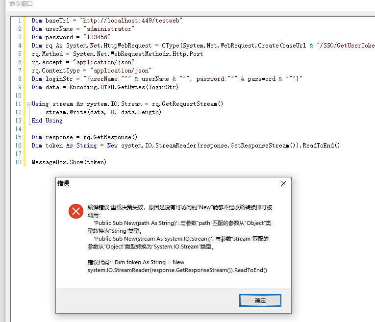

  发帖心情 Post By:2024/11/22 14:40:00 [显示全部帖子]
Dim baseUrl = "http://localhost:449/testweb"
Dim userName = "administrator"
Dim password = "123456"
Dim rq As System.Net.HttpWebRequest = CType(System.Net.WebRequest.Create(baseUrl & "/SSO/GetUserToken"), System.Net.HttpWebRequest)
rq.Method = System.Net.WebRequestMethods.Http.Post
rq.Accept = "application/json"
rq.C
Dim loginStr = "{userName:""" & userName & """, password:""" & password & """}"
Dim data = Encoding.UTF8.GetBytes(loginStr)
Using stream As system.IO.Stream = rq.GetRequestStream()
    stream.Write(data, 0, data.Length)
End Using
Dim response = rq.GetResponse()
Dim token As String = New system.IO.StreamReader(response.GetResponseStream()).ReadToEnd()
MessageBox.Show(token)
我之前试过转成VB 也是一堆报错
rjh4078
  发帖心情 Post By:2024/11/22 15:35:00 [显示全部帖子]
搞定了 感谢兰版图片点击可在新窗口打开查看
