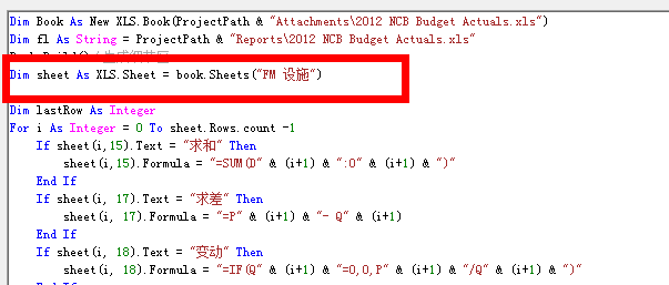

 楼主,你用下面这段代码吧。
 需要你在excel模板里填入公式,但注意公式要左移一位(比如 E4:E9 要写成 D4:D9)
 原本想帮你自动左移一位的,不过这样会复杂一些。你试一下,测试有效。
Dim Book_Mod As New XLS.Book(ProjectPath & "Attachments\2012 NCB Budget Actuals.xls")
Dim Book_Rep As New XLS.Book(ProjectPath & "Attachments\2012 NCB Budget Actuals.xls")
Dim fl As String = ProjectPath & "Reports\2012 NCB Budget Actuals.xls"
Book_Rep.Build() '生成细节区
For Each sheet As XLS.Sheet In book_Mod.Sheets
    For i As Integer = 0 To sheet.Rows.Count - 1
        For j As Integer = 0 To sheet.Cols.Count - 1
            If sheet(i, j).Formula <> "" Then   '是公式
                book_Rep.Sheets(sheet.Name)(i, j-1).Formula = sheet(i, j).Formula   '把公式重新写入
Book_Rep.Save(fl)
Dim Proc As New Process
Proc.File =fl
Proc.Start()
