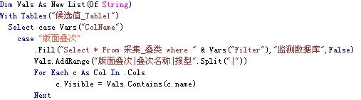

就这样设置啊:

对老六代码的改进,可以同时设置显示的列名和宽度:
        Dim txt as String = "A,100|B,318|C,100"
        Dim i as Integer = 0
        For Each c As Col In .Cols
             Dim Vals() As String = txt.Split("|")
             c.Visible = txt.Contains(c.name & ",")      '加逗号可以保证列名完全匹配
             If c.Visible = True
                 c.Width = Vals(i).substring(Vals(i).indexof(",")+1)
                 i = i + 1
把以上代码做成函数,直接调用起来比datalist还方便!
