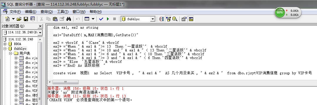

fubblyc
  发帖心情 Post By:2014/3/24 19:08:00 [显示全部帖子]
谢谢jspta  老师,我会建简单的表视图啦。
但是这种复杂的还不会。。。
dim ex1, ex2 as string
ex1="DateDiff( m,MAX(消费日期),GetDate())"
ex2 = vbcrlf  & "(Case" & vbcrlf
ex2+ ="When " & ex1 & ">= 13  Then '一星活跃'"  & vbcrlf
ex2+ ="When " & ex1 & ">= 10 and " & ex1 & " < 13 Then '二星活跃'" & vbcrlf
ex2+ ="When " & ex1 & ">= 6 and " & ex1 & " < 10 Then '三星活跃'" & vbcrlf
ex2+ ="When " & ex1 & ">= 3 and " & ex1 & " < 6 Then '四星活跃'" & vbcrlf
ex2+ = "Else  '五星活跃'" & vbcrlf
ex2+ ="End) As 活跃级别  "
create view  视图1  as Select  VIP卡号 ,  " & ex1 & "  AS 几个月没来买 , " & ex2 & "  from dbo.rjsytVIP消费信息 group by VIP卡号
提示错误:
fubblyc
  发帖心情 Post By:2014/3/24 20:37:00 [显示全部帖子]
哈哈。确实是。现在时间比较赶,这个等后面空点再来学,先暂时用 SQLLoad 方法。
