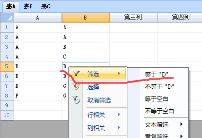

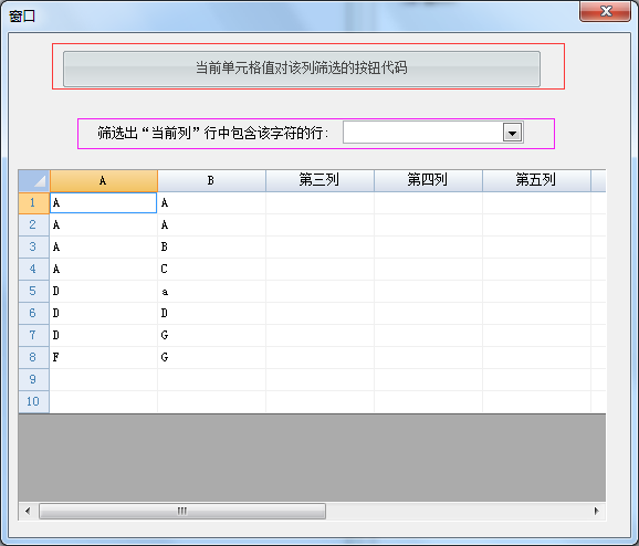

筛选出“当前列”行中包含该字符的行,也不会,请各位老师指点一下了,刚开始学狐表

'按钮点击筛选当前列,关键字为:当前单元格值
Dim txt As String = 当前单元格的值代码怎么写呢?Select(Row, Col)还是CurrentTable.Select(0,0) ??
If txt = "" Then
    Tables("表A").Filter = ""
    Tables("表A").Filter = "当前单元格的函数怎么写呢"
End If

Dim txt As String = e.Form.Controls("ComboBox1").Text '获取控件值
With Tables("表A")
    If txt = "" Then
        .Filter = ""
        .Filter = .Cols(Tables("表A").ColSel).Name & "='" & txt & "'"  '相当于“列名='条件'”
End With

 感谢前辈,不过怎样改成 Like 模糊查询呢?
还有当前单元格的值对当前列、或当前表,进行筛选,的按钮的代码怎么写的?
  发帖心情 Post By:2016/3/6 11:07:00 [只看该作者]
With CurrentTable
    .Filter = .Cols(CurrentTable.ColSel).Name & " like '%" & CurrentTable.Value & "%'"
End With
