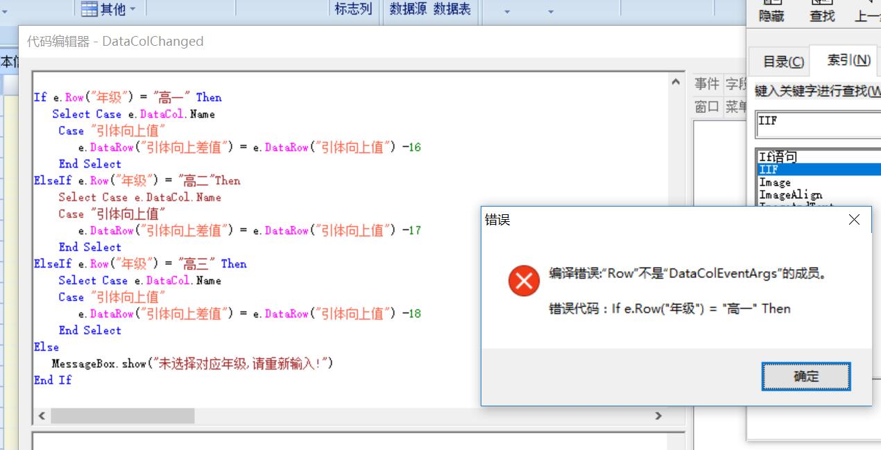

请问下这里那里有问题哦,谢谢  发帖心情 Post By:2017/6/10 11:32:00 [只看该作者]
If e.Row("年级") = "高一" Then
   Select Case e.DataCol.Name
    Case "引体向上值"
       e.DataRow("引体向上差值") = e.DataRow("引体向上值") -16
    End Select
ElseIf e.Row("年级") = "高二"Then
    Case "引体向上值"
       e.DataRow("引体向上差值") = e.DataRow("引体向上值") -17
    End Select
ElseIf e.Row("年级") = "高三" Then
    Case "引体向上值"
       e.DataRow("引体向上差值") = e.DataRow("引体向上值") -18
    End Select
   MessageBox.show("未选择对应年级,请重新输入!")

等级:超级版主 帖子:113802 积分:579589 威望:0 精华:9 注册:2015/6/24 9:21:00
  发帖心情 Post By:2017/6/10 11:44:00 [只看该作者]
e.Row全部改为e.DataRow,不同事件的e参数是不一样的,不要混用:http://www.foxtable.com/webhelp/scr/0604.htm
另外代码这样可能更合理一点
    Case "引体向上值","年级"
        If e.DataRow.Isnull("引体向上值") OrElse e.DataRow.Isnull("年级") Then
            e.DataRow("引体向上差值") = Nothing
            Dim v As Integer = 0
            If e.DataRow("年级") = "高一" Then
                v = 16
            ElseIf e.DataRow("年级") = "高二"Then
                v = 17
            ElseIf e.DataRow("年级") = "高三" Then
                v = 18
                Return
            e.DataRow("引体向上差值") = e.DataRow("引体向上值") - v
End Select

  发帖心情 Post By:2017/6/10 12:04:00 [只看该作者]
谢谢您的解答,受教了,谢谢谢谢
