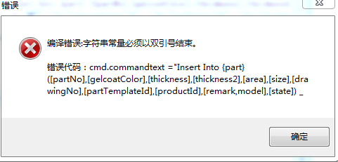

 老师,帮我看下代码有点问题,
   Dim cmd As New SQLCommand
    cmd.C
    For Each r As Row In Tables("滑道构成_Table3").Rows
        If r IsNot Nothing Then
            For i As Integer = 1 To r("amount")
                cmd.commandtext ="Insert Into {part} ([partNo],[gelcoatColor],[thickness],[thickness2],[area],[size],[drawingNo],[partTemplateId],[productId],[remark,model],[state]) _
                Values( '" &r("partNo")&"','"&r("gelcoatColor")&"','"&r("backColor")&"','"&r("thickness")&"', '"&r("thickness2")&", _
                '"&r("area")&"','"&r("size")&"','"&r("drawingNo")&"','"&r("partTemplateId")&"','"&r("productId")&"','"&r("remark")&"','"&r("model")&"',"ll")"
                cmd.ExecuteNonQuery
huli503
等级:幼狐 帖子:130 积分:1688 威望:0 精华:0 注册:2016/10/1 20:59:00
  发帖心情 Post By:2017/8/17 21:49:00 [只看该作者]
出现这个错误

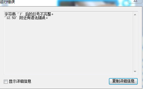

  发帖心情 Post By:2017/8/17 21:55:00 [只看该作者]
            cmd.commandtext ="Insert Into {part} ([partNo],[gelcoatColor],[backColor],[thickness],[thickness2],[area],[size],[drawingNo],[partTemplateId],[productId],[remark],[model],[state]) " & _
            "Values( '" & r("partNo") & "','" & r("gelcoatColor") & "','" & r("backColor") & "','" & r("thickness") & "', '" & r("thickness2") & "," & _
            "'" & r("area") & "','" & r("size") & "','" & r("drawingNo") & "','" & r("partTemplateId") & "','" & r("productId") & "','" & r("remark") & "','" & r("model") & "','ll')"
            output.show(cmd.CommandText)
            cmd.ExecuteNonQuery
huli503
  发帖心情 Post By:2017/8/17 22:15:00 [只看该作者]
老师,运行出现这个错误
