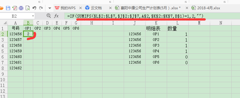

求和的结果如是等于1,显示为指定数字:2,如果以下这个求和的结果=1,显示为数字3,以此类推,如图Select Case e.DataCol.Name
    Case "加工工序","毛坯编码","生产日期","班次"
        Dim Filter3 As String = "毛坯编码 = '" & e.DataRow("毛坯编码") & "' and 加工工序 = '" & e.DataRow("加工工序") & "' and 生产日期 = '" & Date.Today & "' And 班次 = '中班'"
        e.DataRow("完成数量") = DataTables("每日排产").SQLCompute("Sum(加工数量)", Filter3)
        e.DataRow.save
End Select

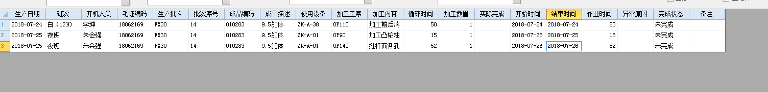

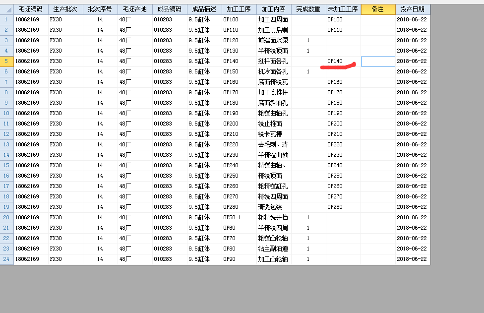

如图2是汇总表,如图1是明细表,为什么以下代码不能正常汇总呢?谢谢
        Dim Filter As String = "毛坯编码 = '" & e.DataRow("毛坯编码") & "' and 加工工序 = '" & e.DataRow("加工工序") & "' and 生产日期 = '" & Date.Today & "' And 班次 = '夜班'"
        e.DataRow("完成数量") = DataTables("每日排产").SQLCompute("Sum(加工数量)", Filter)
        If e.DataRow("完成数量") = 1 Then
            e.DataRow("完成数量") = 4
            e.DataRow("完成数量") = Nothing
        e.DataRow.save
End Select

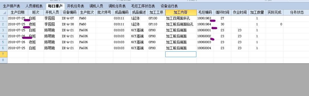

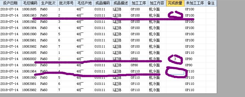

老师,写了两段代码却只能求和一段代码的结果,如图1,但明细表里却有三个结果,如图2
        Dim Filter As String = "毛坯编码 = '" & e.DataRow("毛坯编码") & "' and 加工工序 = '" & e.DataRow("加工工序") & "' and 生产日期 = '" & Date.Today & "' And 班次 = '白班'"
        e.DataRow("完成数量") = DataTables("每日排产").Compute("Sum(加工数量)", Filter)
            e.DataRow("完成数量") = 2
        e.DataRow.save
End Select
        Dim Filter As String = "毛坯编码 = '" & e.DataRow("毛坯编码") & "' and 加工工序 = '" & e.DataRow("加工工序") & "' and 生产日期 = '" & Date.Today.adddays(1) & "' And 班次 = '白班'"
            e.DataRow("完成数量") = 3
        e.DataRow.save
End Select
  发帖心情 Post By:2018/7/25 23:10:00 [只看该作者]
        e.DataRow.save
End Select
        e.DataRow.save
End Select
