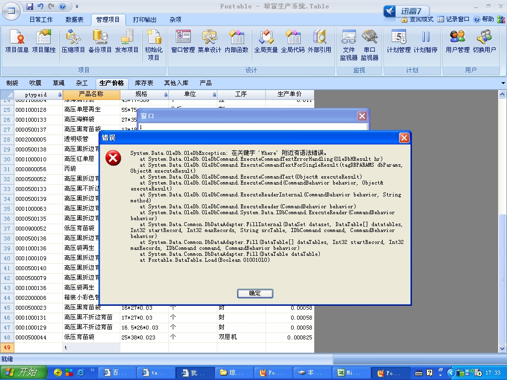

上个月 打得好好地,停了几天到这个月就突然出错了。
一定要说 有where 代码的话
只有这里了
Dim txt As String = e.Form.Controls("TextBox1").Text
Dim tbl As Table = Tables("窗口4_Table1")
Dim Filter As String
Dim Sort As String
If txt = "" Then
       Filter =" leveal=2 and deleted=0 and isstop=0"
       Sort = "pfullname desc,Standard desc,Unit1 desc"
       txt = "'%" & txt & "%'"   '这里用%,不是*
      filter = "(pfullname Like " & txt & " Or Standard Like " & txt & " Or Unit1 Like " & txt & ") and (leveal=2 and deleted=0 and isstop=0)"
tbl.DataTable.LoadFilter = Filter
tbl.DataTable.Load
tbl.sort = sort

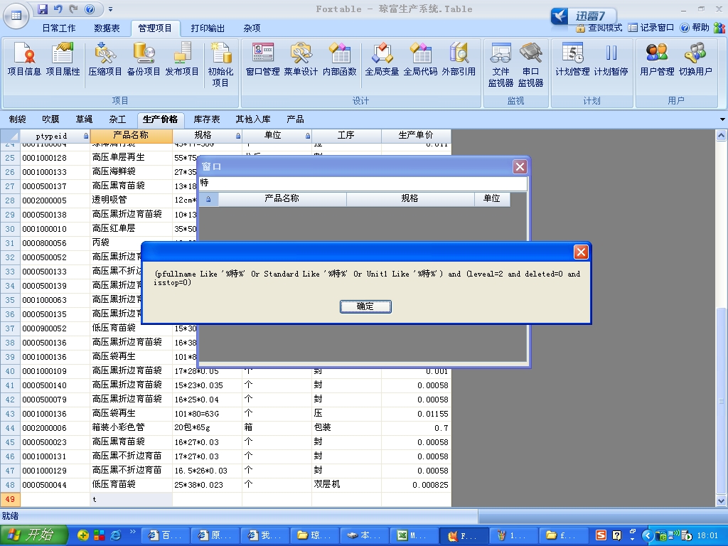

  发帖心情 Post By:2011/9/5 17:50:00 [只看该作者]
前面加一行,看看合成的Filter是啥:
MessageBox.show(filter)
tbl.DataTable.Load
tbl.sort = sort

leveal   => level  ???
[此贴子已经被作者于2011-9-5 21:26:18编辑过]
