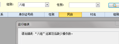

初学者一个,在制作多用户环境下的筛选时,要求每个用户只能在自己的权限内进行内容的筛选,写入代码后,提示缺少表达式,大佬帮我看看哪里出错了。
Dim Filter As String
With e.Form.Controls("组别")
    If .Value IsNot Nothing Then
        Filter = Filter &  "组别 = '" & .Value & "'"
End With
With e.Form.Controls("性别")
        If Filter > "" Then
            Filter = Filter & " And "
        Filter = Filter &  "性别 = '" & .Value & "'"
End With
If Filter > "" Then
    Select Case user.name
        Case "田万水"
            Tables("木溪乡人口数据").Filter = Filter
        Case "桐油坡"
             Tables("木溪乡人口数据").Filter = "[村名] = '桐油坡村' And  '" & Filter & "'"
     End Select
  发帖心情 Post By:2018/10/30 23:05:00 [只看该作者]
Tables("木溪乡人口数据").Filter = "[村名] = '桐油坡村' And  " & Filter

谢谢大佬,问题已解决
