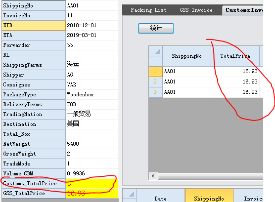

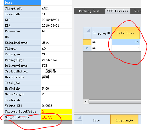

老师,请帮忙解答一下,图中的两个加总为什么不对,并附实列。非常谢谢帮忙。
shipment表属性的代码如下
If e.DataCol.Name = "ShippingNo" Then
    Dim Arys As List(Of String())  = DataTables("GSSInvoice").GetValues("shippingno|Totalprice","ShippingNo='" & e.NewValue & "'")
    Dim sum As Double= 0
    For Each s As String() In arys
        sum += val(s(1))
    e.DataRow("GSS_totalprice") = sum
    Dim Arys As List(Of String())  = DataTables("CustomsInvoice").GetValues("shippingno|Totalprice","ShippingNo='" & e.NewValue & "'")
        sum += val(s(1))
    e.DataRow("CUSTOMS_totalprice") = sum
customsinvocie 表属性的代码如下
If e.DataCol.Name <> "Totalprice" Then '发生变化的是产品列.
   Dim pr As DataRow
   pr = DataTables("Shipment").Find("ShippingNo = '" & e.DataRow("ShippingNo") & "'")
   If pr IsNot Nothing Then
     DataTables("Shipment").DataCols("ShippingNo").RaiseDataColChanged(pr)
End  If
gssinvocie 表属性的代码如下
   Dim pr As DataRow
End  If

图片点击可在新窗口打开查看点击浏览该文件:test.table
  发帖心情 Post By:2018/11/17 16:02:00 [只看该作者]
改为
If e.DataCol.Name = "ShippingNo"  orelse e.DataCol.Name = "Totalprice" Then

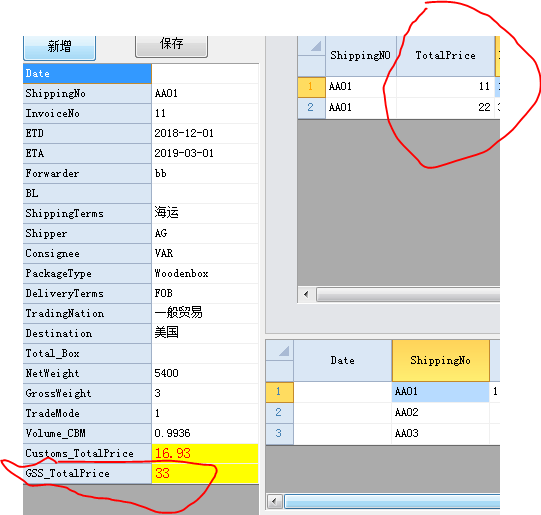

  发帖心情 Post By:2018/11/17 20:30:00 [只看该作者]
老师,还是有点问题,两个记录值相同时,它就取一个了,不加总了。只有数值不同时才会相加。 我们要它们都相加,该如何修改,谢谢。
  发帖心情 Post By:2018/11/18 22:04:00 [只看该作者]
If e.DataCol.Name = "ShippingNo"  OrElse e.DataCol.Name = "Totalprice" Then
    For Each dr As DataRow In DataTables("GSSInvoice").Select("ShippingNo='" & e.NewValue & "'")
        sum += dr("Totalprice")
