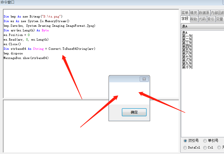

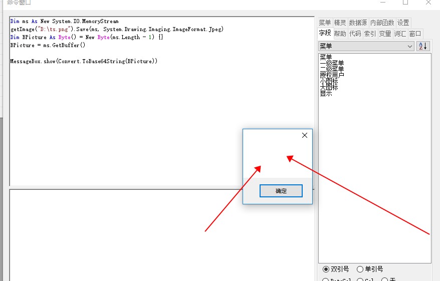

[求助]怎么我用论坛一样的64位图像编码代码,获取的是空的  发帖心情 Post By:2019/4/15 22:45:00 [只看该作者]
Dim ms As New System.IO.MemoryStream
getImage("D:\ts.png").Save(ms, System.Drawing.Imaging.ImageFormat.Jpeg)
Dim BPicture As Byte() = New Byte(ms.Length - 1) {}
BPicture = ms.GetBuffer()
MessageBox.show(Convert.ToBase64String(BPicture))
  发帖心情 Post By:2019/4/15 23:14:00 [只看该作者]
Dim bmp As new Bitmap("D:\ts.png")
Dim ms As new System.Io.MemoryStream()
bmp.Save(ms, System.Drawing.Imaging.ImageFormat.Jpeg)
Dim arr(ms.Length) As Byte
ms.Position = 0
ms.Read(arr, 0, ms.Length)
ms.Close()
Dim strbase64 As String = Convert.ToBase64String(arr)
bmp.dispose

回复:(有点蓝)Dim bmp As new Bitmap("D:\ts.png")...  发帖心情 Post By:2019/4/16 15:09:00 [只看该作者]
还是一样的,什么都没有,是为什么?
