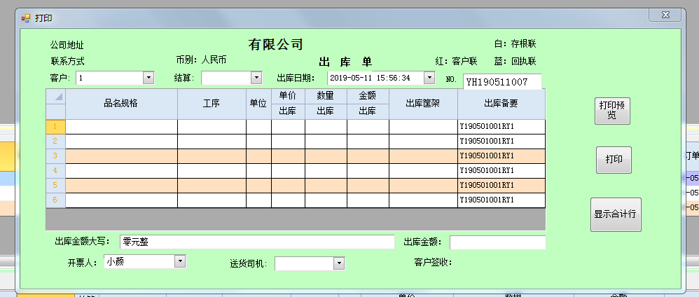

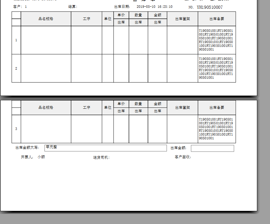

最后一行补齐表高,这个已经ok了,
还有一个问题,
遇到同一批出库产品,需要出库编号相同的,打印3行,但一页却只能打得下一行
剩余两页怎么做到:窗口中的除“表边框内的内容”以外的全部内容都与第一页相同,
也就是:每页只添加了剩余要打印的表边框内的内容

  发帖心情 Post By:2019/5/11 11:31:00 [只看该作者]
把窗口表最大打印行数去掉
Dim fdr1 As DataRow = DataTables("意和打印记录表").Find("日期 >= #" & d1.Date & "# and 日期 < #" & d1.Date.adddays(1) & "#")
if fdr1 isnot nothing then fdr1("次数") += 1
'针式打印机的连进连出打印:
e.Form.Page.LeftMargin = 0 '设置左边距
e.Form.Page.RightMargin = 0 '设置右边距
e.Form.Page.TopMargin = 0 '设置上边距
e.Form.Page.BottomMargin = 0 '设置下边距
Dim doc As PrintDoc = e.Form.GernatePrintDoc()
doc.PageSetting.Width = 218  '纸张宽度为218毫米
doc.PageSetting.Height = 94  '纸张高度为94毫米
doc.AutoRotate = False  '如果纸张的宽度超过高度,要加上这行代码
Dim ndoc As new PrintDoc
Dim ra_1 As new prt.RenderArea
Dim ra_2 As new prt.RenderArea
Dim ra_3 As new prt.RenderArea
Dim flag As Boolean = False
For Each c As object In Doc.Body.Children
    If c.Gettype.name Like "*RenderText*" Then
        If flag = False Then
            ra_1.Children.Add(c.Clone)
            Dim nrt = c.clone
            nrt.height = 0
            ra_2.Children.Add(nrt)
            ra_2.Children.Add(c.clone)
    ElseIf c.Gettype.name Like "*RenderTable*" Then
        ra_3.Children.Add(c.Clone)
        Dim nrt = c.clone
        nrt.height = 0
        flag = True
ndoc.Body.Children.Add(ra_3)
nDoc.PageHeader = ra_1 '作为页眉使用
ndoc.PageFooter = ra_2
ndoc.PageSetting.LeftMargin = 0 '设置左边距
ndoc.PageSetting.RightMargin = 0 '设置右边距
ndoc.PageSetting.TopMargin = 0 '设置上边距
ndoc.PageSetting.BottomMargin = 0 '设置下边距
ndoc.PageSetting.Width = 218  '纸张宽度为218毫米
ndoc.PageSetting.Height = 94  '纸张高度为94毫米
ndoc.AutoRotate = False  '如果纸张的宽度超过高度,要加上这行代码
ndoc.Preview()

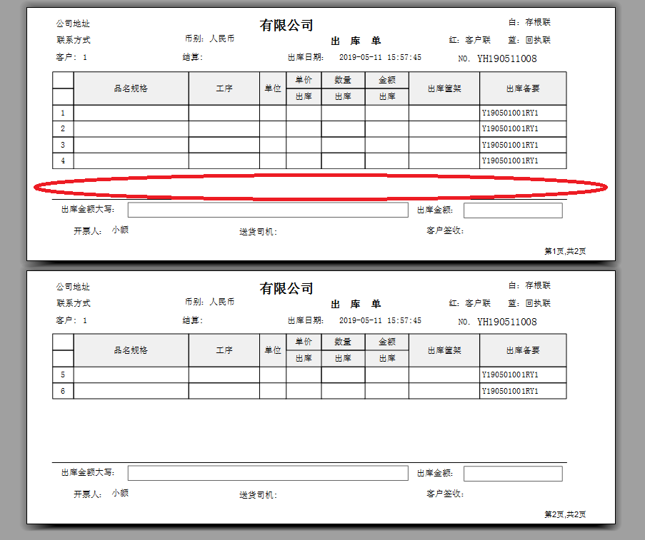

回复:(有点蓝)把窗口表最大打印行数去掉Dim fdr1 A...  发帖心情 Post By:2019/5/11 13:52:00 [只看该作者]
nDoc.PageFooter = "第[PageNo]页,共[PageCount]页"
ndoc.Preview()
不知道红色的这句应该怎么改?

  发帖心情 Post By:2019/5/11 14:56:00 [只看该作者]
Dim rt = New prt.RenderText '设置文本对象的内容
rt.Text = "第[PageNo]页,共[PageCount]页" '设置文本内容
rt.Style.TextAlignHorz = prt.AlignHorzEnum.Right
rt.Style.Padding.Bottom = 2
rt.Style.Padding.right= 10
rt.Y = "Prev.Bottom + 2"
rt.Style.FontSize = 8
ra_2.Children.Add(rt)
ndoc.Preview()
fengwenliuyan
等级:四尾狐 帖子:904 积分:8363 威望:0 精华:0 注册:2012/10/19 13:55:00
回复:(有点蓝)……ndoc.Body.Children.Add(ra_3)nD...  发帖心情 Post By:2019/5/11 16:03:00 [只看该作者]
上面第二幅图中,红色部分空挡区域,应该怎么去除?
