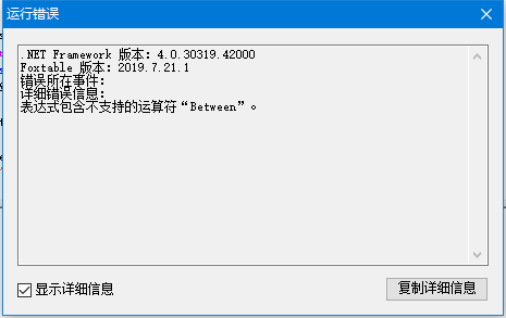

老师,有这个报错
Dim area As String = "0-90,110-120" '面积
Dim area1 As String = "101" '区域1
Dim area2 As String = "10101" '区域2
Dim total As String = "0-90,110-120" '价格
Dim shape As String = "0-1,1-2,2-3" '房型
Dim houseage As String = "1-2" '房龄
Dim Filter As String
If  area1 > "" Then
    Filter = "一级区域 = '" & area1 & "'"
If  area2 > "" Then
    If Filter > "" Then
        Filter = Filter & " And "
        Filter = Filter & "二级区域 = '" & area2 & "'"
If  area > "" Then
    If Filter > "" Then
    Dim Values() As String
    Values = area.split(",")
    Dim f2 As String = " ( 1=2 "
    For Each s As String In Values
        f2 = f2 & " or 面积 BETWEEN " & s.Replace("-"," and ")
    Filter = Filter & f2 & " ) "
If  total > "" Then
    If Filter > "" Then
    Values = total.split(",")
        f2 = f2 & " or 售价 BETWEEN " & s.Replace("-"," and ")
If  shape > "" Then
    If Filter > "" Then
    Values = shape.split(",")
        f2 = f2 & " or 室 BETWEEN " & s.Replace("-"," and ")
If  houseage > "" Then
    If Filter > "" Then
    Values = houseage.split(",")
        f2 = f2 & " or 房龄 BETWEEN " & s.Replace("-"," and ")
output.Show(filter)
Tables("房产信息").Filter = Filter
  发帖心情 Post By:2019/8/27 16:46:00 [只看该作者]
output.Show(filter) 看看完整SQL
lxhmax
等级:三尾狐 帖子:645 积分:5772 威望:0 精华:0 注册:2012/8/2 19:04:00
  发帖心情 Post By:2019/8/27 16:51:00 [只看该作者]
区域 = '惠城' And 片区 = '东平' And  ( 1=2  or 面积 BETWEEN 0 and 90 )
这样的报错
  发帖心情 Post By:2019/8/27 17:00:00 [只看该作者]
嗯,表达式不支持BETWEEN,比如这样
改为
f2 = f2 & " or 面积 >= " & s.Replace("-"," and 面积 <= ")
其它地方参考自己改改
