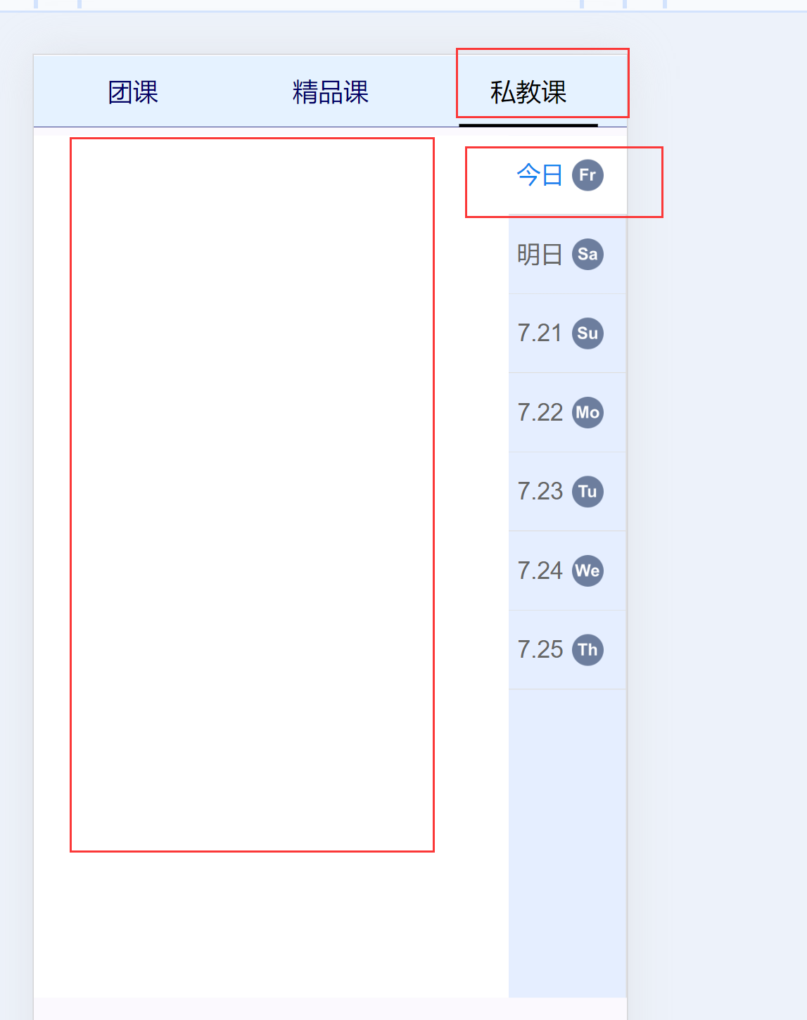

 Dim tab1 As ExWeUI.ExSideTab = ExWeUI.WebUI.AddSideTab("", "stab1", 1)
    tab1.AddPage("st11", "今日", "renamecxtq.htm?type=tuanke&riqi=" & riqi(1), "./images/" & xingqi(1) & ".png", True)
 Dim tab2 As ExWeUI.ExSideTab = ExWeUI.WebUI.AddSideTab("", "stab2", 1)
    tab2.AddPage("st12", "今日", "renamecxtq.htm?type=jingpinke&riqi=" & riqi(1), "./images/" & xingqi(1) & ".png", True)
 Dim tab3 As ExWeUI.ExSideTab = ExWeUI.WebUI.AddSideTab("", "stab3", 1)
    tab3.AddPage("st13", "今日", "renamecxtq.htm?type=sijiaoke&riqi=" & riqi(1), "./images/" & xingqi(1) & ".png", True)
wb.AppendHTML("<style>#tab011_panel{height:550px}</style>", True) '插入标签高度
wb.AppendHTML("<style>#tab021_panel{height:550px}</style>", True) '插入标签高度
wb.AppendHTML("<style>#tab031_panel{height:550px}</style>", True) '插入标签高度
With ExWeUI.WebUI.AddTabsGroup("", "tg02")
    .Attribute = "style = 'line-height: 45px;background-color:#e5f2ff;color:#000066'" '自定义设置标签背景色/高度等
    .ActiveColor = "black" '设置当前标签颜色
    With .AddPage("tab011", "团课")
        .Content = tab1.BuildHtml
    End With
    With .AddPage("tab021", "精品课")
        .Content = tab2.BuildHtml
    End With
    With .AddPage("tab031", "私教课")
        .Content = tab3.BuildHtml
    End With
    wb.InsertHTML("yueke", .BuildHtml) '插入到约课页面
End With

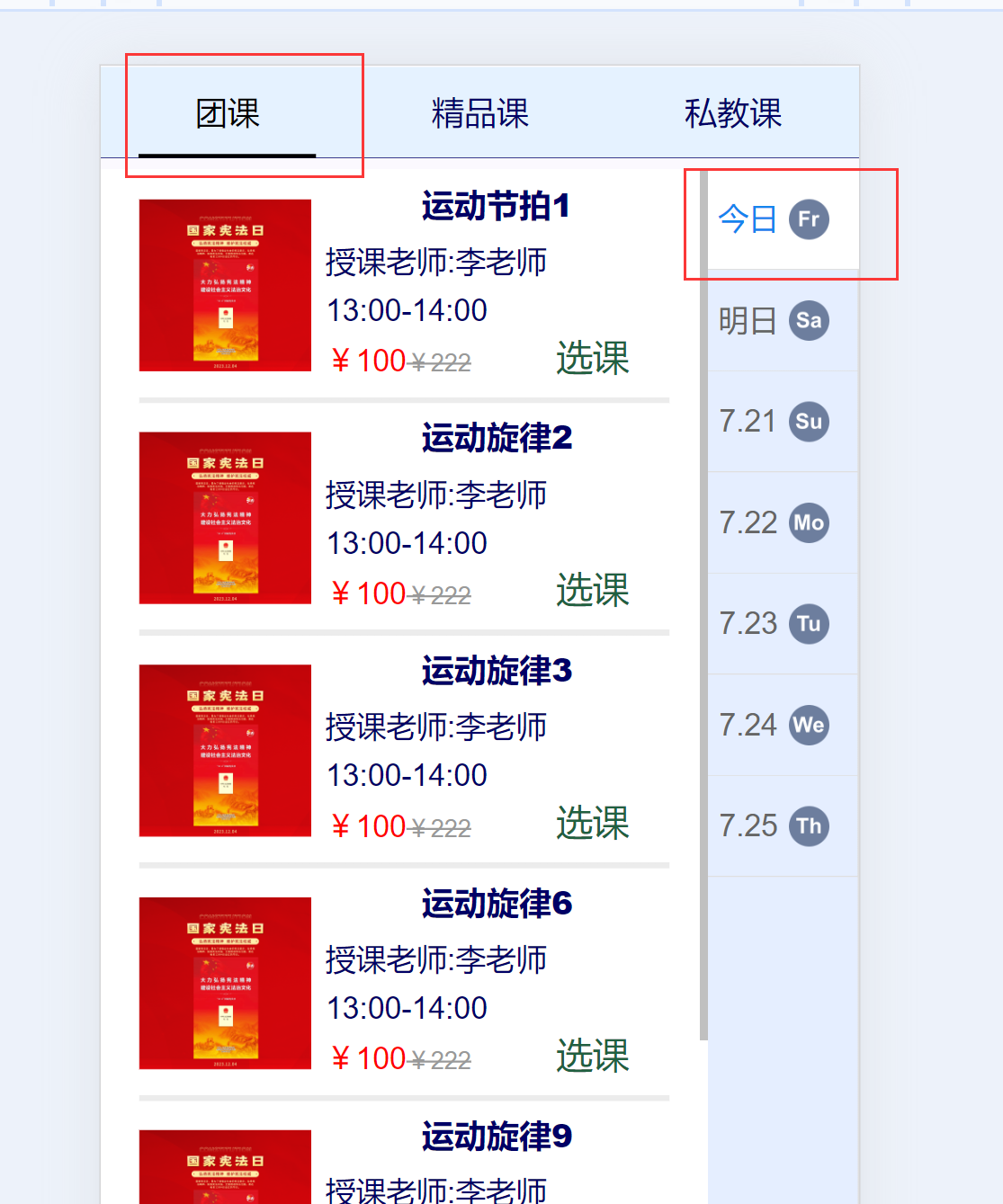

在刚刷新页面时,系统自动就会调取页面,但是我点到私教课这个页面时,初始是没有对应内容的,需要手动点一下今日才能调出后台页面。
  发帖心情 Post By:2024/7/20 10:43:00 [只看该作者]
组件设计时只考虑到一个页面一个SideTab的情况,自己另外使用js处理一下
        wb.AppendHTML("<script>initExWeUI();document.getElementById('st12').click();</script>")
