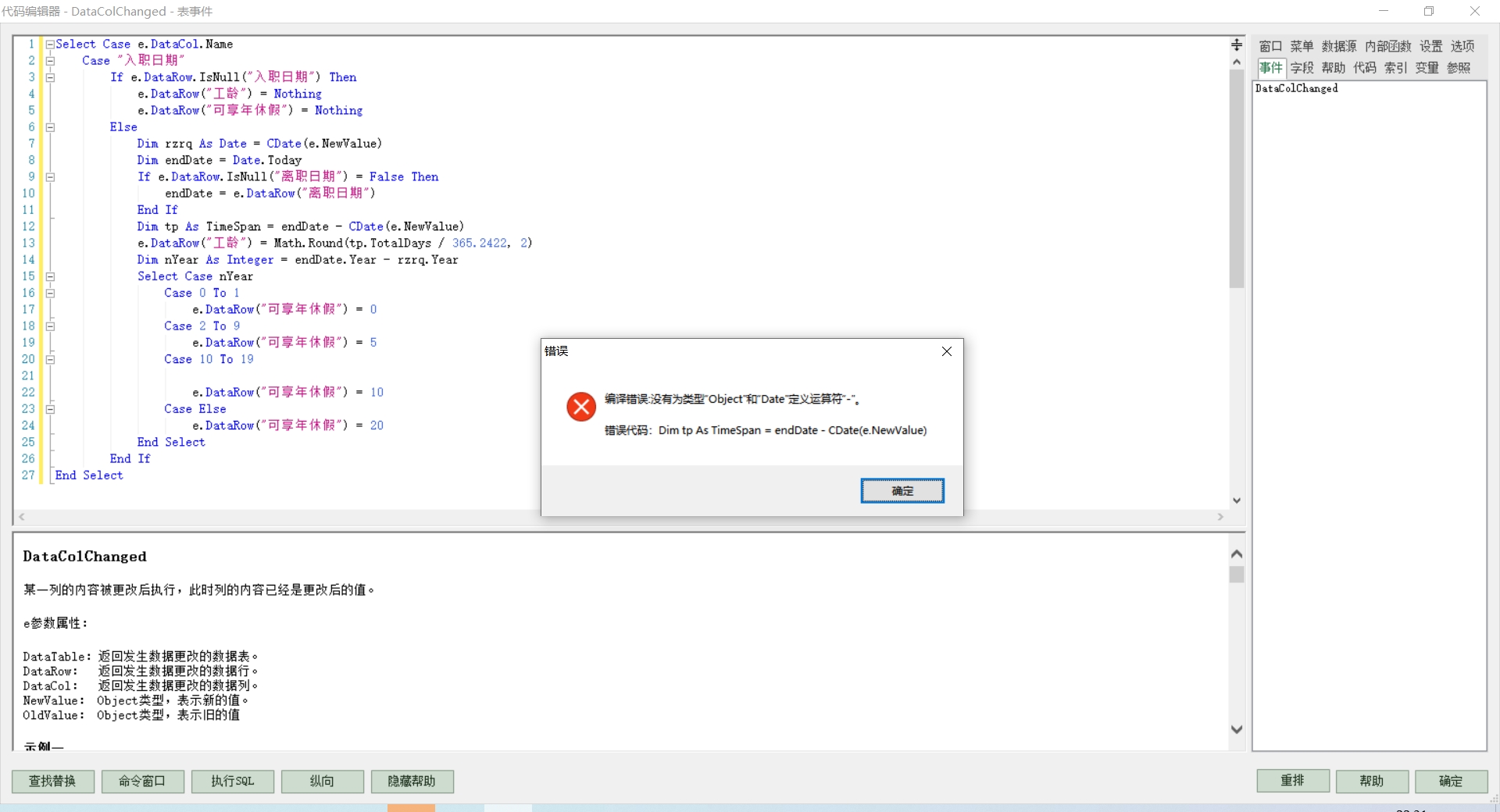

您好!报错了?  发帖心情 Post By:2025/4/6 22:35:00 [只看该作者]
出现以下报错,详见附件,谢谢
  发帖心情 Post By:2025/4/6 22:41:00 [只看该作者]
Dim endDate = Date.Today
改为
Dim endDate as date = Date.Today
