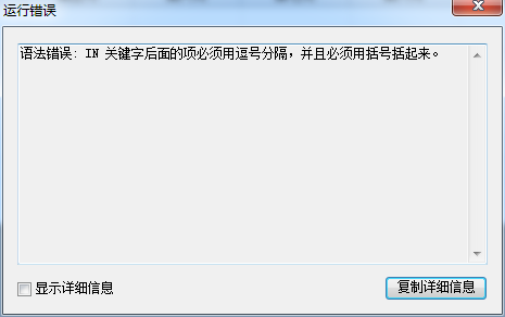

如图,愿望很简单。
就是点击表a某列的时候,自动把 表b中第一列含有表a当前行(第一行)的行筛出来,思路知道,就是看下面公式怎么错了?
    Tables("表b").Filter = "第一列 In  '(" &  e.Table.Current("第一列")  & ")'"
lsy
  发帖心情 Post By:2013/5/12 9:19:00 [只看该作者]
Tables("表b").Filter = ""
Dim flt As String
Dim str() As String
For Each r As Row In Tables("表b").Rows
    str = r("第一列").Split(",")
    For Each s As String In str
        If e.Table.Current("第一列") = s Then
            flt = flt & "'" & r("第一列") & "'" & ","
If flt > "" Then
   flt = "第一列 In (" & flt.TrimEnd(",") & ")"
   Tables("表b").Filter = flt
   Tables("表b").Filter = (1 = 2)
