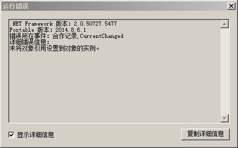

另外启动完项目时还是有错误提示,如下:
代码如下:
If Forms("合作记录主窗").Opened = True Then
    Dim pg As WinForm.TabPage
    pg = Forms("合作记录主窗").Controls("TabControl1").TabPages("效果图")
    If e.Table.Current("效果图") IsNot Nothing AndAlso e.Table.Current("效果图") = ""  Then
        pg.Visible = False
        pg.Visible = True    '
    Dim pg1 As WinForm.TabPage
    pg1 = Forms("合作记录主窗").Controls("TabControl1").TabPages("设计资料")
    If Tables("合作记录.设计要求表").Rows.Count = 0  Then
        pg1.Visible = False
        pg1.Visible = True    '
