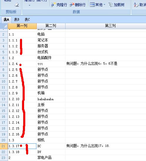

  发帖心情 Post By:2014/10/5 14:56:00 [只看该作者]
还有一点问题,看例子表格或截图。
图片点击可在新窗口打开查看点击浏览该文件:数字级码生成.table

  发帖心情 Post By:2014/10/5 15:05:00 [只看该作者]
代码
Dim dt As DataTable = DataTables("表A")
dt.DataRows.Clear
Dim dic As New Dictionary(of Integer, Integer)
Dim prevLevel As Integer = 0
For Each nd As WinForm.TreeNode In e.Form.Controls("TreeView1").AllNodes
    If dic.ContainsKey(nd.Level) = False Then
        dic.Add(nd.Level, 1)
        If nd.level < prevLevel Then
            dic(prevLevel) = 0
            dic(nd.Level) = dic(nd.Level) + 1
        prevLevel = nd.Level
    Dim ndr As DataRow = dt.AddNew
    Dim str As String = ""
    For i As Integer = 0 To nd.Level
        str &= dic(i) & "."
    ndr("第一列") = str.TrimEnd(".")
    ndr("第二列") = nd.Text
