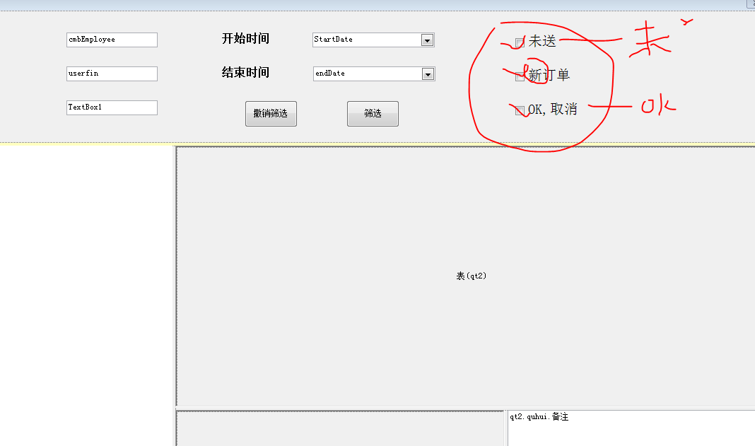

多选的时候,只显示一个,其他两个备选的不显示,应该怎么改?  发帖心情 Post By:2015/11/5 23:52:00 [只看该作者]

按此在新窗口浏览图片
这个图我设计的是 把选择按钮都选上的话,三个相应的结果都能出来才对,
但是现在,如果我选中 两个,或者三个的话,
结果只会 筛选其中的一个,代码如上 麻烦指点一下
Hyphen
  发帖心情 Post By:2015/11/6 8:19:00 [只看该作者]
Dim Filter As String = "1=1"
With e.Form.Controls("userfin")
    If .Value IsNot Nothing Then
        Filter = " name = '" & .Value & "'"
End With
Dim f2 As String
With e.Form.Controls("userfin1")
    If .Checked = True Then
        f2 = "状态 = '未送'"
End With
With e.Form.Controls("ok")
    If f2 > "" Then
        f2 = f2 & " or "
        f2 &= "状态 = 'ok' "
End With
With e.Form.Controls("new")
    If f2 > "" Then
        f2 = f2 & " or "
        f2 &= "状态 = '新'"
End With
If f2 > "" Then
    Filter = Filter & " and (" & f2 & ")"
With e.Form.Controls("cmbEmployee")
        If Filter >"" Then
            Filter = Filter & " And "
        Filter = Filter & "shangcheng = '" & .Value & "'"
End With
With e.Form.Controls("StartDate")
        If Filter >"" Then
        Filter = Filter & "time >= #" & .Value & "#"
End With
With e.Form.Controls("EndDate")
        If Filter >"" Then
        Filter = Filter & "time <= #" & .Value & "#"
End With
If Filter > "" Then
    Tables("qt2").Filter = Filter
    '     Tables("weixin").Filter = Filter
