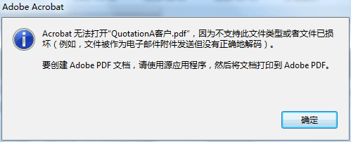

请问下,需要打印当前报价单编号相同的报价明细,代码如下,出现上面错误,如何解决?是我代码有问题?

  发帖心情 Post By:2016/5/9 16:00:00 [只看该作者]
Dim fl As String = ProjectPath & "Reports\QuotationA客户.pdf"
改成
Dim fl As String = ProjectPath & "Reports\QuotationA客户.xls"
  发帖心情 Post By:2016/5/9 16:01:00 [只看该作者]
如果要转pdf,参考
http://www.foxtable.com/help/topics/2930.htm

  发帖心情 Post By:2016/5/9 16:23:00 [只看该作者]
还是不行,结果不是想要的内容
  发帖心情 Post By:2016/5/9 16:25:00 [只看该作者]
Dim Book As New XLS.Book(ProjectPath & "Attachments\QuotationA客户.xls") '打开模板
Dim Sheet As XLS.Sheet = Book.Sheets(0)
Dim Filter As String
With Tables("A客户Grip_Table2")
    If .current("报价单编号") Is Nothing Then
        filter = "False"
        Filter = "报价单编号 = '" & .Current("报价单编号") & "'"
End With
If filter > "" Then
    Sheet(3,19).Value = "<" & filter & ">"
    Sheet(3,19).Value = "<all>"
Book.Build() '生成报表
Book.SaveToPDF(fl)
Dim Proc As New Process
Proc.File = fl
Proc.Start()
