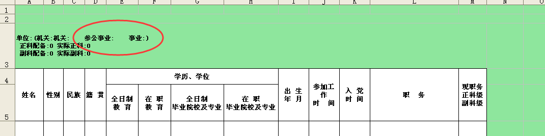

认真看过后加红色的修改是否能达到 机关后续没有字段就不显示机关、参公事业后面没有字段就不显示参公事业  事业后面没有字段就不显示事业,之前老师给过分开的例子但是我这S7都是和在一起的啊?  如何修改呢?

  发帖心情 Post By:2017/4/14 11:08:00 [只看该作者]
    Dim s8 as string = dt.GetComboListString("下属部门", filter & " and 单位性质 = '机关'").replace("|", ",").trim(",")
    Dim s9 as string = dt.GetComboListString("下属部门", filter & " and 单位性质 = '参公事业'").replace("|", ",").trim(",")
    Dim s10 as string= dt.GetComboListString("下属部门", filter & " and 单位性质 = '事业'").replace("|", ",").trim(",")
    s7 &= iif(s8 > "", "机关:" & s8, "")
    s7 &= iif(s9 > "", "参公事业::" & s9, "")
    s7 &= iif(s10 > "", "事业:" & s10, "")
guimingze
等级:幼狐 帖子:120 积分:895 威望:0 精华:0 注册:2017/2/15 20:56:00
回复:(有点色)    Dim s8 as strin...  发帖心情 Post By:2017/4/14 14:19:00 [只看该作者]
如何修改呢?  老师还是实现不了啊

  发帖心情 Post By:2017/4/14 14:33:00 [只看该作者]
Select Case e.Book.TempLate
Case "横名册"
    Dim Filter As String = "单位名称 = '" & e.DataRow("单位名称") & "'"
    Dim dt As DataTable = DataTables("竖名册")
    Dim sum1 As Double = dt.Compute("Sum(正科配备)",Filter)
    Dim sum2 As Double = dt.Compute("Sum(实际正科)",Filter)
    Dim sum3 As Double = dt.Compute("Sum(副科配备)",Filter)
    Dim sum4 As Double = dt.Compute("Sum(实际副科)",Filter)
    Dim s1 As String = dt.GetComboListString("正科职数空缺", filter).replace("|", ",").trim(",")
    Dim s2 As String = dt.GetComboListString("正科职数备注", filter).replace("|", ",").trim(",")
    Dim s3 As String = dt.GetComboListString("副科职数空缺", filter).replace("|", ",").trim(",")
    Dim s4 As String = dt.GetComboListString("副科职数备注", filter).replace("|", ",").trim(",")
    Dim s5 As String = dt.GetComboListString("下属部门", filter).replace("|", ",").trim(",")
    Dim jg As String = dt.GetComboListString("下属部门", filter & " and 单位性质 = '事业'")
    s1 = iif(s1 > "",  "正科职数空缺:" & s1, "")
    s2 = iif(s2 > "",  "正科职数备注:" & s2, "")
    s3 = iif(s3 > "",  "副科职数空缺:" & s3, "")
    s4 = iif(s4 > "",  "副科职数备注:" & s4, "")
    Dim s8 As String = dt.GetComboListString("下属部门", filter & " and 单位性质 = '机关'").replace("|", ",").trim(",")
    Dim s9 As String = dt.GetComboListString("下属部门", filter & " and 单位性质 = '参公事业'").replace("|", ",").trim(",")
    Dim s10 As String= dt.GetComboListString("下属部门", filter & " and 单位性质 = '事业'").replace("|", ",").trim(",")
    Dim s7 As String = ""
    e.Book.Marks("分组统计字符") = "单位:" & e.DataRow("单位名称") & "(" & s7.Trim() & ")" & Chr(13) & Chr(10) & " 正科配备:" & sum1 & " 实际正科:" & sum2 & " " & s1 & " " & s2 & Chr(13) & Chr(10) & " 副科配备:" & sum3 & " 实际副科:" & sum4 & " " & s3 & " " & s4
