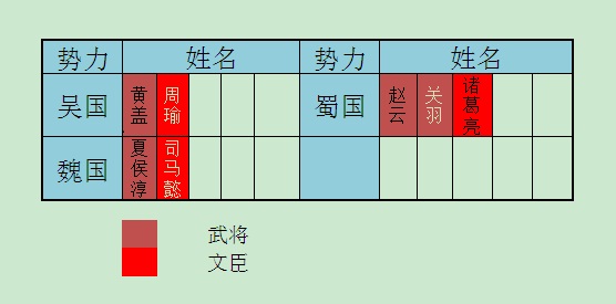

我简单做了一下数据:
图片点击可在新窗口打开查看点击浏览该文件:可视化员工一览表.table
想做成这样一种效果:
要求员工的“势力”改变时,在一览表中其能自动转换到新的“势力”后面;这个该如何实现?
至于标注颜色的问题已经学会了,谢谢 有点色 老师
  发帖心情 Post By:2017/8/18 12:09:00 [只看该作者]
参考,自行扩充
Dim dt As DataTable = DataTables("员工信息表")
Dim pcount As Integer = 1
For Each sl As String In dt.GetValues("势力")
    Dim pnl As WinForm.panel
    pnl = e.Form.CreateControl("lable1", ControlTypeEnum.panel)
    pnl.Left = 100
    pnl.Top = 100 * pcount
    pnl.width = 500
    pnl.height = 100
    e.Form.AddControl(pnl)
    pcount += 1
    Dim lcount As Integer = 0
    For Each dr As DataRow In dt.Select("势力 = '" & sl & "'")
        Dim lbl As WinForm.label
        lbl = e.Form.CreateControl("lable" & dr("姓名"), ControlTypeEnum.Label)
        lbl.Text = dr("姓名")
        lbl.Left = 10 + lcount*100
        lbl.Top = 10
        If dr("类型") = "武将" Then
            lbl.backcolor = Color.red
        ElseIf dr("类型") = "文臣" Then
            lbl.backcolor = Color.yellow
        lcount += 1
        pnl.AddControl(lbl)
