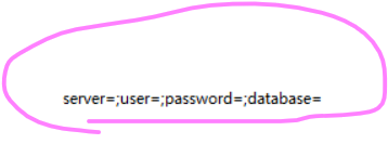

等级:六尾狐 帖子:1418 积分:9796 威望:0 精华:0 注册:2019/6/13 9:57:00
  发帖心情 Post By:2024/9/27 15:00:00 [显示全部帖子]
1.调试:
Dim connStr As String = cexp("serve-r={0};user={1};password={2};database={3}", configData.server, configData.user, configData.password, configData.database)
msgbox(connStr) '调试用
按此在新窗口浏览图片

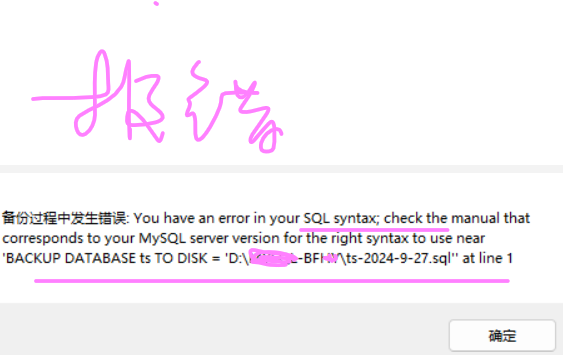

lgz518
  发帖心情 Post By:2024/9/27 16:23:00 [显示全部帖子]
Using conn As New MySql.Data.MySqlClient.MySqlConnection(connStr)
    Try
        conn.Open() ' 打开连接
        Dim backupSql As String = "BACKUP DATABASE ts TO DISK = 'D:\BF\ts-2024-9-27.sql'"
        Using cmd As New MySql.Data.MySqlClient.MySqlCommand(backupSql, conn)
            cmd.ExecuteNonQuery()
            MessageBox.Show("备份成功!")
        End Using
        Catch ex As Exception
        ' 处理异常
        MessageBox.Show("备份过程中发生错误: " & ex.Message)
    Finally
        conn.Close() ' 确保关闭连接
    End Try
End Using
红代码报错如图,如何处理?
lgz518
  发帖心情 Post By:2024/9/27 16:55:00 [显示全部帖子]
网上搜,MySql做备份,不是SqlServer的,报错上面的错,不知道怎么,网上搜不到?
