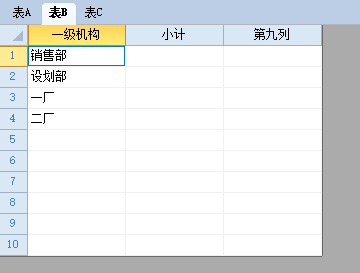

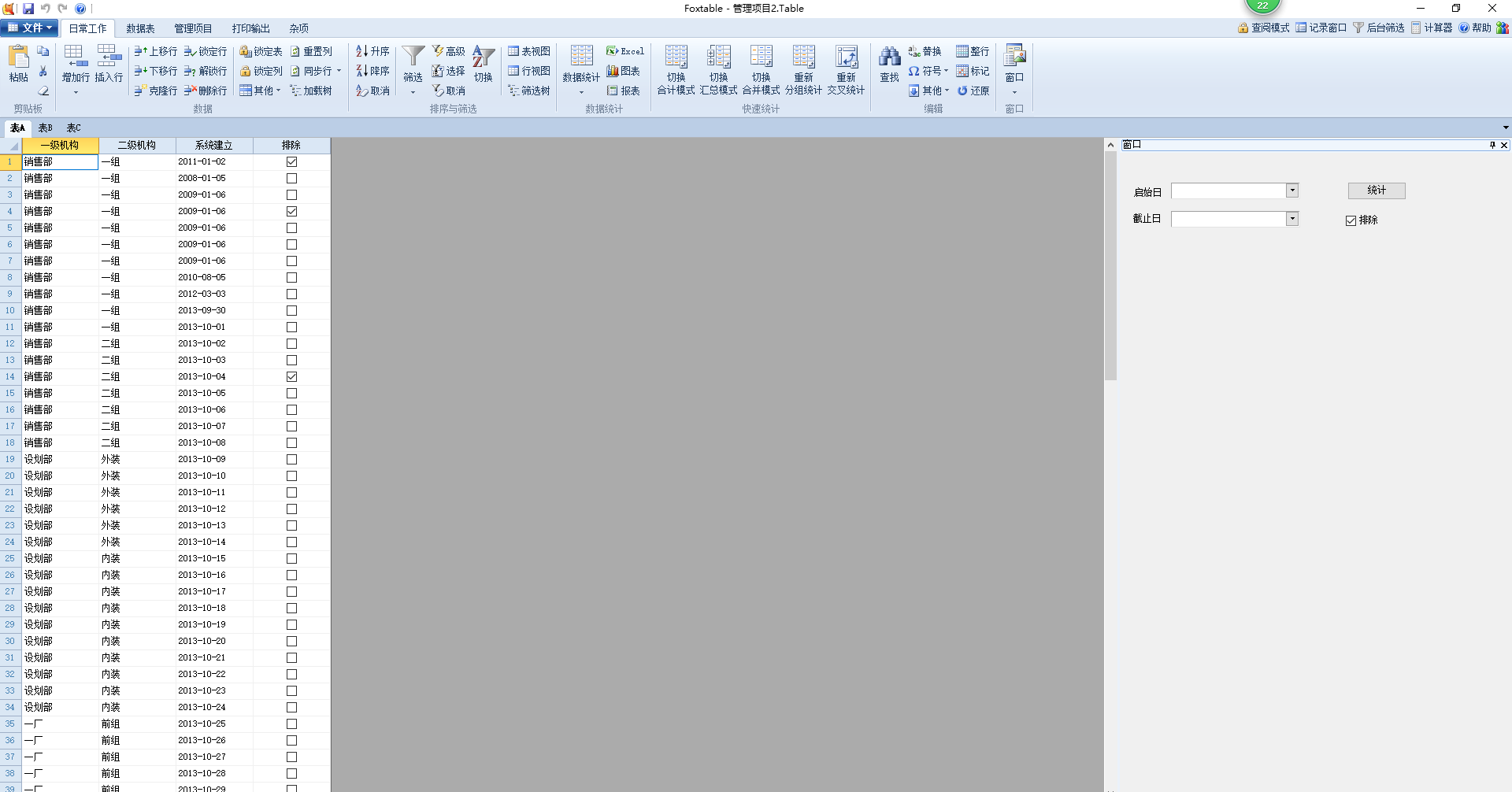

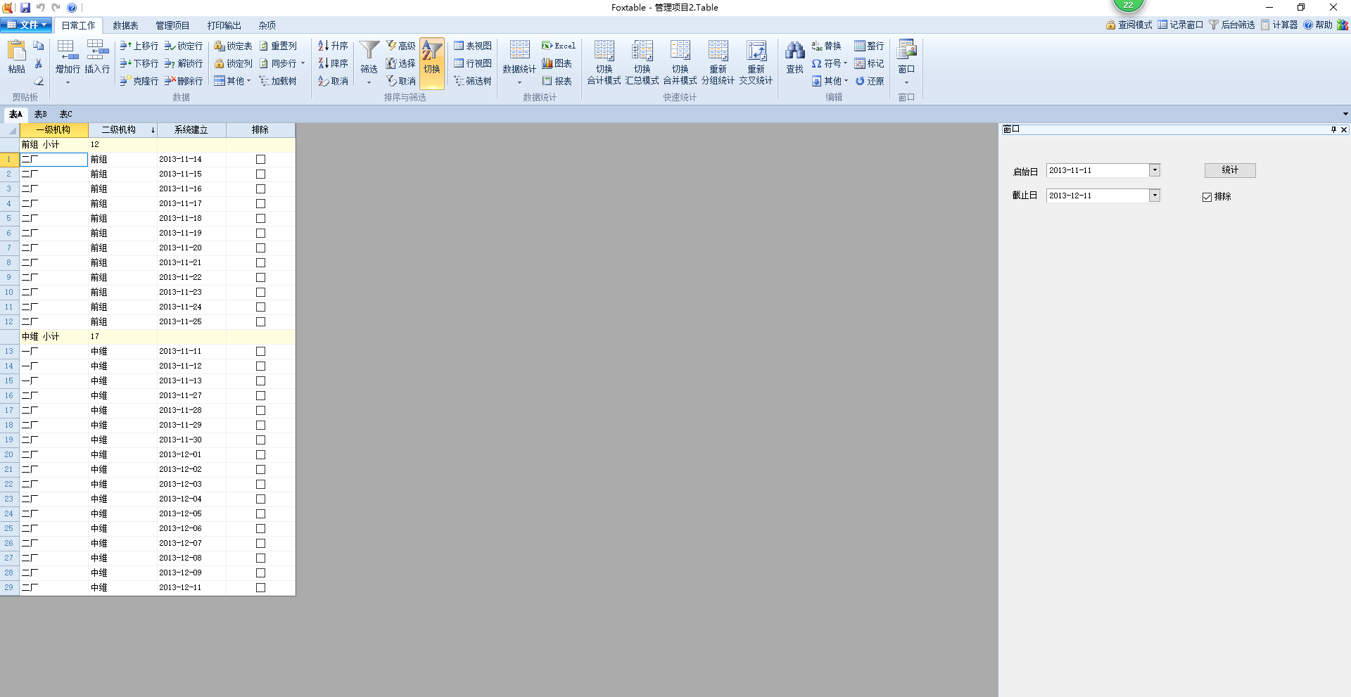

老师些,本人小白一枚,我通过筛选后再进行小计数量,如何把得到的小计写入表B对应的单元格里呀?
Dim Filter As String
With e.Form.Controls("StartDate")
    If .Value IsNot Nothing Then
        If Filter >"" Then
            Filter = Filter & " And "
        Filter = Filter & "系统建立 >= #" & .Value & "#"
End With
With e.Form.Controls("EndDate")
        If Filter >"" Then
        Filter = Filter & "系统建立 <= #" & .Value & "#"
End With
If e.Form.Controls("rdigh").Checked = True
    If Filter >"" Then
    Filter = Filter & "排除 = false"
If Filter > "" Then
    Tables("表A").Filter = Filter
Dim t As Table = Tables("表A")
Dim g As Subtotalgroup
t.SubtotalGroups.Clear()
t.GroupAboveData = True
t.TreeVisible = False
t.SpillNode = True
g = New Subtotalgroup
g.Aggregate = AggregateEnum.Count
g.GroupOn = "二级机构"
g.TotalOn = "二级机构"
g.Caption = "{0} 小计"
t.SubtotalGroups.Add(g)
t.Subtotal()

  发帖心情 Post By:2018/10/7 14:29:00 [只看该作者]
首先这个逻辑有问题,表B是按照一级进行分类,表A却是按照二级进行汇总,结果无法对应
统计的代码大概可以参考这样
For Each dr As DataRow In DataTables("表B").Select("一级机构 is not null")
    dr("小计") = Tables("表A").Compute("Count(级机构)","一级机构='" & dr("一级机构") &"'")

  发帖心情 Post By:2018/10/7 14:40:00 [只看该作者]
不好意思,是我搞错了,是对二级机构时间小计,也可以用这样的代码吗?
  发帖心情 Post By:2018/10/7 14:44:00 [只看该作者]
可以,放到统计按钮最后即可
For Each dr As DataRow In DataTables("表B").Select("二级机构 is not null")
    dr("小计") = Tables("表A").Compute("Count(级机构)","级机构='" & dr("级机构") &"'")
