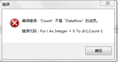

For Each dr1 As Row In DataTables("单位系数").Rows
    For Each dr2 As DataCol In DataTables("单位系数").DataCols
        For i As Integer = 0 To dr1.Count-1
            If dr1.IsNull("部门")  Then
                dr1(dr2.Name) = Nothing
                Dim pr As Double = DataTables("个人数据").Compute("Sum(系数_1)","[部门_ & dr2.name] = '" & dr1("部门") & "'")
                dr1(dr2.Name) = pr
[此贴子已经被作者于2012-6-13 15:58:06编辑过]
yyzlxc
等级:七尾狐 帖子:1530 积分:10639 威望:0 精华:0 注册:2008/9/24 11:16:00
  发帖心情 Post By:2012/6/13 15:56:00 [只看该作者]
谢谢xongyijd老师的回复,但是代码在命令窗口未能通过,另外循环就是12个月,还请指教,谢谢!!

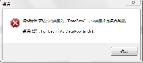

这样看看:
For Each dr1 As DataRow In DataTables("单位系数").DataRows
        For Each i As DataRow In dr1
            If i.IsNull("部门")  Then
                i(dr2.Name) = Nothing
                Dim pr As Double = DataTables("个人数据").Compute("Sum(系数_1)","["部门] = '" & dr1("部门") & "'")
                i(dr2.Name) = pr
yyzlxc
  发帖心情 Post By:2012/6/13 16:12:00 [只看该作者]
谢谢xongyijd老师的回复,好像还是不行。

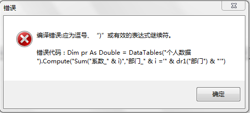

另外,在命令窗口运行上面加黄色标记的这段代码,出现的错误提示如下,估计可能就是双引号单引号的问题,还请指教,谢谢!!
  发帖心情 Post By:2012/6/13 16:20:00 [只看该作者]
    For i As Integer = 1 To 12
            dr1("月系数_" & i) = Nothing
            Dim pr As Double = DataTables("个人数据").Compute("Sum(系数_" & i & ")","[部门_" & i & "] ='" & dr1("部门") & "'")
            dr1("月系数_" & i) = pr
