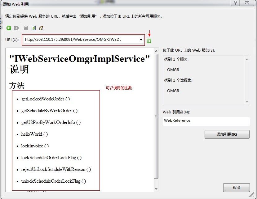

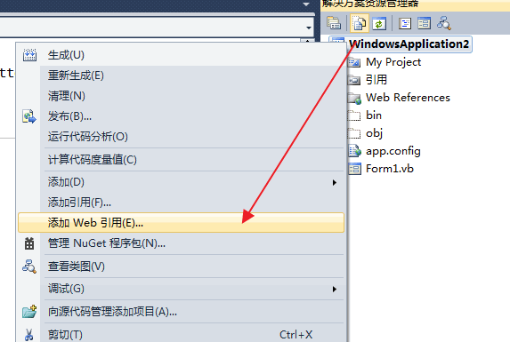

  发帖心情 Post By:2016/11/16 15:26:00 [只看该作者]
引入vs,生成dll给狐表调用吧,这样方便好多
图片点击可在新窗口打开查看点击浏览该文件:windowsapplication2.zip

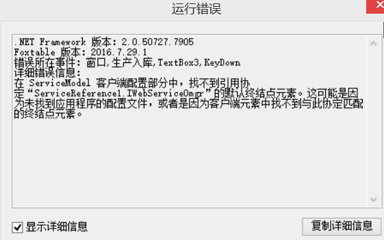

VS 添加类的代码。生成了ClassLibrary1。然后ft引用。
Public Class Class1
    Dim web As New ServiceReference1.WebServiceOmgrClient()
    Public Function getScheduleByWorkOrder(ByVal workOrderNo As String, ByVal lineNo As String) As String
        Return web.getScheduleByWorkOrder(workOrderNo, lineNo)
    End Function
End Class
keydown代码:运行出现附件错误。
Dim gdhhh As WinForm.TextBox = e.Form.Controls("TextBox3")
If e.KeyCode = keys.enter Then
    If gdhhh.text.Contains("-") Then
        Dim id As Integer = gdhhh.text.IndexOf("-")
        Dim str1 As String = gdhhh.text.SubString(0,id)
        Dim str2 As String = gdhhh.text.SubString(id + 1)
        Dim dl As new ClassLibrary1.Class1()
        MessageBox.Show(dl.getScheduleByWorkOrder(str1,str2))
    End If
End If
