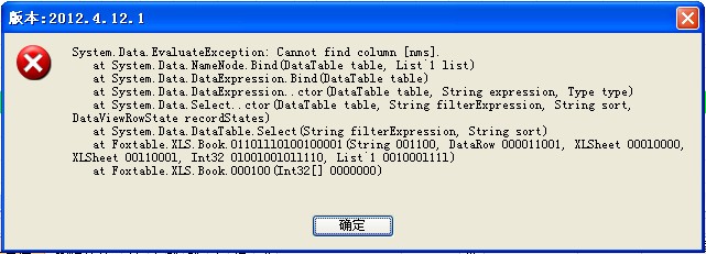

我改了后,还是报错了,请指教。
dim nms As List(of String) = DataTables("结算表").GetUniqueValues("","客户")
For Each nm As String in nms
     Dim Book As New XLS.Book(ProjectPath & "Attachments\结算单-2013模板")
     Dim fl As String = ProjectPath & "Reports\“ & nm & ”.xls"
Dim Sheet As XLS.Sheet = Book.Sheets(0)
Sheet(8,36).Value = "< nms >"
     Book.Build() '生成细节区
     Book.Save(fl) '保存工作簿
Dim Proc As New Process
Proc.File = fl
Proc.Start()
lin_hailun
  发帖心情 Post By:2013/1/5 14:31:00 [只看该作者]
 看看这样行不行。不行的话,把你的数据表上传上来测试。
Dim nms As List(of String) = DataTables("结算表").GetUniqueValues("","客户")
For Each nm As String In nms
    Dim Book As New XLS.Book(ProjectPath & "Attachments\结算单-2013模板.xls")
    Dim fl As String = ProjectPath & "Reports\" & nm & ".xls"
    Sheet(8, 9).Value = "<客户 = '" & nm & "'>"
    Book.Build() '生成细节区

SZDVYE
等级:童狐 帖子:213 积分:2228 威望:0 精华:0 注册:2012/2/3 14:14:00
  发帖心情 Post By:2013/1/5 23:41:00 [只看该作者]
谢谢您,问题已经解决了。
