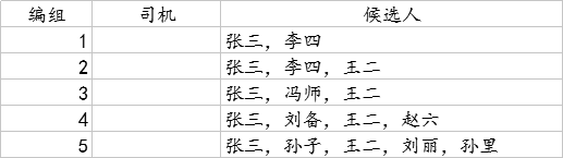

想做了一个排班系统,如下图所示:
从候选人中选取1名作为每一组的司机,每组司机不能相同,比如第1组选定张三后,其他组都不能选取。想用遍历的方法选出5组司机,并计算总共有多少种可能性,比如:1. 张三2李四3王二4刘备5孙子;1. 李四2张三3王二4刘备5孙子;请教一下代码的思路,菜鸟,谢谢!

如果层数是固定的,建议直接写多层循环,否则,就需要写成递归。下面代码,是三层的,看懂代码
Dim dt As DataTable = DataTables("表A")
Dim drs = dt.Select("第二列 is not null")
Dim s0 As String = drs(0)("第二列")
For Each ss0 As String In s0.split(",")
    Dim s1 As String = drs(1)("第二列")
    Dim ls As new List(Of String)
    ls.add("")
    ls.add("")
    ls.add("")
    ls(0) = ss0
    For Each ss1 As String In s1.split(",")
        If ls.contains(ss1) Then Continue For
        ls(1) = ss1
        Dim s2 As String = drs(2)("第二列")
        For Each ss2 As String In s2.split(",")
            If ls.contains(ss2) Then Continue For
            ls(2)= ss2
            output.show(String.Join("|", ls.ToArray))

谢谢,代码看懂了。层数不固定,能不能请教一下递归代码,谢谢
  发帖心情 Post By:2018/2/23 11:36:00 [只看该作者]
loop函数
Dim drs = args(0)
Dim ls = args(1)
Dim level = args(2)
If level = drs.count Then
    For Each s As String In drs(level)("第二列").split(",")
        Dim iscontains = False
        For i As Integer = 0 To level-1
            If ls(i) = s Then
                iscontains = True
                Exit For
        If iscontains Then Continue For
        If ls.count < level+1 Then
            ls.add(s)
            ls(level) = s
        functions.Execute("loop", drs, ls, level+1)
调用代码
Functions.Execute("loop", drs, ls, 0)
