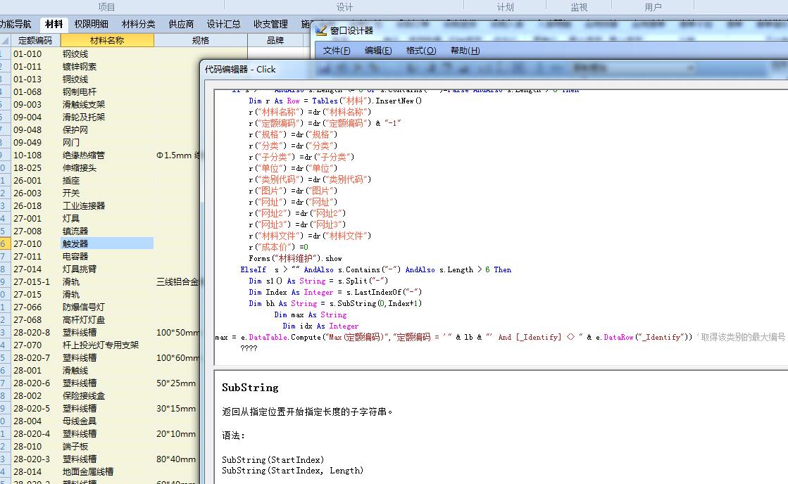

    ElseIf  s > "" AndAlso s.Contains("-") AndAlso s.Length > 6 Then
        Dim s1() As String = s.Split("-")
        Dim Index As Integer = s.LastIndexOf("-")
        Dim bh As String = s.SubString(0,Index+1)
yancheng
等级:四尾狐 帖子:844 积分:5999 威望:0 精华:0 注册:2013/6/29 9:36:00
  发帖心情 Post By:2016/3/22 13:20:00 [只看该作者]
怎么才能把帮助的,自动增加编号 ,溶入呢?

max = e.DataTable.Compute("Max(定额编码)","定额编码 like '" & bh & "%' And [_Identify] <> " & e.DataRow("_Identify"))
