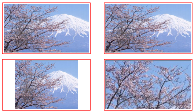

示例一
Dim file As String = "c:\temp\test.pdf"
Dim
pdc As New PDFCreator()
Dim
rect As New RectangleF(72, 72, 210, 120)
Dim
rectBorder As RectangleF = rect
rectBorder.Inflate(3, 3)
Dim
img As Image = GetImage("Fujiyama.png")
常规绘制
pdc.DrawImage(img, rect)
pdc.DrawRectangle(pens.Red, rectBorder)
拉伸绘制,常规绘制就是拉伸绘制
rect.Offset(250, 0)
rectBorder.Offset(250, 0)
pdc.DrawImage(img, rect, ContentAlignment.TopLeft, PDF.ImageSizeModeEnum.Stretch)
按比例缩放绘制
rect.Offset( - 250, rect.Height + 20)
rectBorder.Offset( - 250, rect.Height + 20)
pdc.DrawImage(img, rect, ContentAlignment.MiddleCenter, PDF.ImageSizeModeEnum.Scale)
剪切绘制
rect.Offset(250, 0)
p
dc.DrawImage(img, rect, ContentAlignment.TopLeft, PDF.ImageSizeModeEnum.Clip)
pdc.Save(file)
Process.Start(file)
生成的文档为:
示例二
