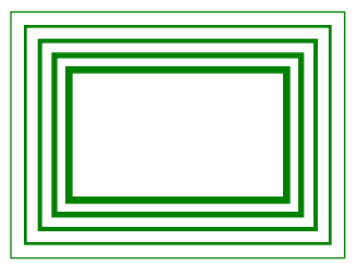

示例二
Dim file As String = "c:\temp\test.pdf"
Dim
pdc As New PDFCreator()
Dim
rect As New RectangleF(100, 100, 150, 90)
For
i As Integer = 1 To 5
Dim pen As New Pen(color.Green, 6 - i)
    pdc.DrawRectangle(pen, rect)
    rect.Inflate(10, 10)
pdc.Save(file)
Process.Start(file)
生成的文档:
