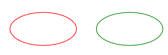

示例一
Dim file As String = "c:\temp\test.pdf"
Dim
pdc As New PDFCreator()
Dim
rect As New RectangleF(72, 72, 100, 50)
pdc.DrawEllipse(pens.Red, rect)
pdc.DrawEllipse(pens.Green, 202, 72, 100, 50)
pdc.Save(file)
pdc.Show()
生成的文档:

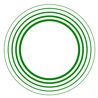

示例二
Dim
Dim
rect As New RectangleF(100, 100, 150, 150)
For
i As Integer = 1 To 5
Dim pen As New Pen(color.Green, 6 - i)
    pdc.DrawEllipse(pen, rect)
    rect.Inflate(10, 10)
pdc.Save(file)
Process.Start(file)
生成的文档:
