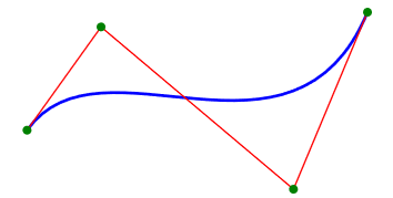

示例
Dim file As String = "c:\temp\test.pdf"
Dim
pdc As New PDFCreator
定义数据点
Dim
pts() As PointF = {
New
PointF(100, 200), New PointF(150, 130),
New
PointF(280, 240), New PointF(330, 120)
pdc.DrawBezier(
New pen(color.Blue, 2), pts(0), pts(1), pts(2), pts(3)) '绘制贝塞尔曲线
pdc.DrawLines(Pens.Red, pts)
'绘制连接数据点的直线
For
Each pt As PointF In pts '绘制数据点标记
    pdc.FillEllipse(Color.Green, pt.X - 3, pt.Y - 3, 6, 6)
pdc.Save(file)
pdc.Show()
绘制的图形:
